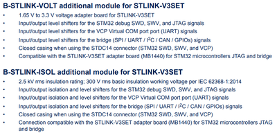

And neither the B-STLINK-VOLT additional module for STLINK-V3SET nor the B-STLINK-ISOL additional module for STLINK-V3SET would be able to supply the circuit with the 3V3, right?
2024-08-22 7:36 AM
No. Power doesn't appear on any standard debug headers.
If you are making your own programmer, I'm sure you can find a 3.3V rail on the actual board to tie into. But again, probably better options here (e.g. Nucleo board).

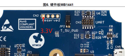

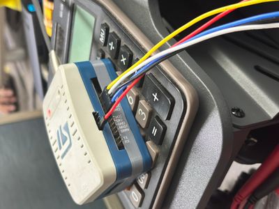

2025-03-10 1:38 AM
Hey Roitav,
I just connected the power of 3.3V in the V3set and using it, then I found you have the same trouble on this,
so I am happy to let you know how to get it, see the pictures in below :
