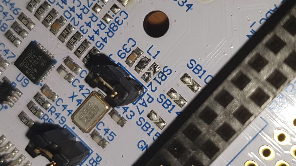

Dear all,
as I wanted to have my own Vref+ for ADC conversions I removed solder bridge SB12 (coupling Vref+ with VDD) to input my own reference voltage (~3V) at Pin 6 CN7.
After removing the SB12 however the STM 32 device is not found anymore. I can still connect with the ST-Link and trying to reflash the device I get the following from CubeProgrammer:

So did I physically destroyed something while removing the SMD or did I trigger some failure state that I can somehow reset? Any help is appreciated.
PS: Resoldering the bridge did not help. Surface looks clean, no unintended solder bridges visible.
PS2: LD7 blinks for a fraction of a second when attaching or detaching the ST-Link USB cable.

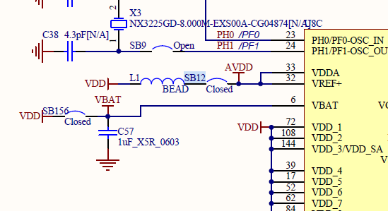

SB12 connects VDD to VDDA (as well as VREF+). VDDA and VDD must always be connected per the datasheet.
If you put VDD=3.3 and VDDA=3.0, and redoing the bridge didn't fix it, I would guess it's dead. Although it still is reporting a board, so clearly it's still partially working.

Thank you that is what I needed! Where did you get the datasheet from - it does not appear to be available from the ST Nucleo page.
I upped the CN 7 Pin 6 voltage to 3.3V and I was able to connect to the device again after some trial and error, however unable to run the code that did previously run. I erased the device with CubeProgrammer and resoldered SB12, but this time without the 0 Ohm SMD but just the solder and it works again now.
So as far as I see it is impossible to connect an independent Vref+ without affecting all the other curcuits that are connected to VDDA on the STM32767ZI.
It's a schematic from the ST Nucleo page under CAD Resources:
https://www.st.com/en/evaluation-tools/nucleo-f767zi.html#cad-resources
