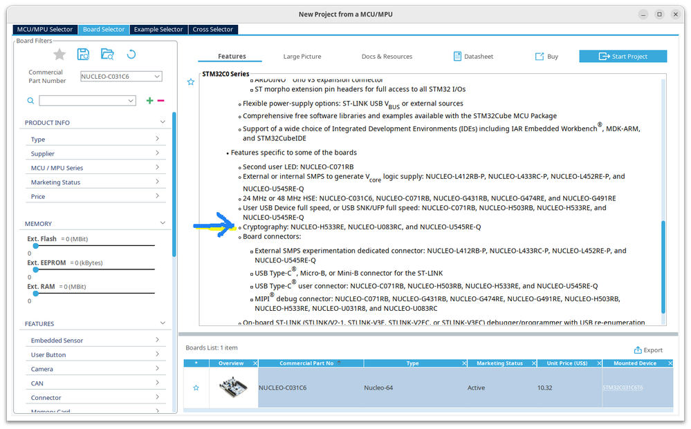

When in the description of features of a Nucleo board, it says:
Cryptography: NUCLEO-H533RE, NUCLEO-U083RC, and NUCLEO-U545RE-Q
As in the case of the NUCLEO-C031C6 in its description.

2025-01-19 11:51 AM
Hi @STTwo-32
In CubeMX, when reading the description of the Nucleo Board, it only says:
"Cryptography: NUCLEO-H533RE, NUCLEO-U083RC, and NUCLEO-U545RE-Q"
I didn't understand if it's a comparison, that is, other Nucleo board has the resource as in the suggested µC, or if one of these is present on the board.
2025-01-19 11:54 AM
Could you please be more specific. Maybe the screenshot helps.
Best Regards.
STTwo-32

2025-01-19 12:55 PM - edited 2025-01-19 12:56 PM
This is a global description that tels the user that in some of our NUCLEO boards, we may have some features that you Will not find in other board such as the Cryptography. To know if a specific board does have a specific feature (such as crypto) you may use the methode that i have Said on the first commant.
