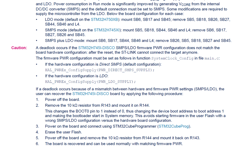

Yes the STM32H7 was Bricked , I am able to now recover the board 10K resistance De-Soldered from R143 and Soldered on to R144 .( There should have been an Jumper provided or ,,, the ST-LINK should have had GPIO method to recovered the board )
After Going through the user manual it is mentioned in an Caution: :sad_but_relieved_face:

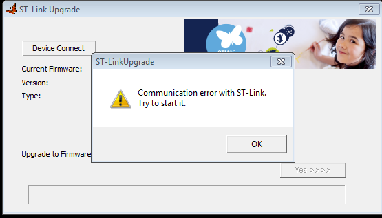

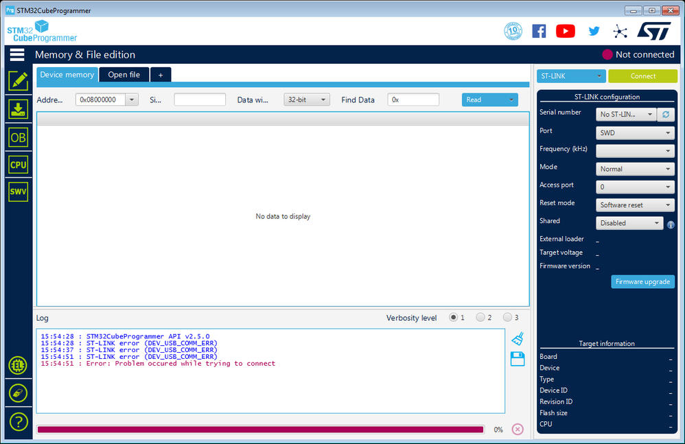

From STM32CubeProgrammer interface, try to perform a Firmware upgrade. Is that possible?
Does it resolve your issue?

Seems more likely that the H7 is bricked with user software, and the ST-LINK here isn't switching to DFU/Update mode. Don't think this board provides jumpers to disconnect SWDIO/SWCLK from the target.

Hi ,
