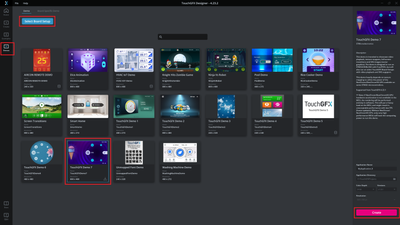

Hello @Southbranch ,
At the moment the only way you can get the source code of this demo is by creating a project in TouchGFX Designer.
First, if it is not done yet, download TouchGFX.
Open TouchGFX Designer, click on Demos, then select "Demo 7".
Finally, "Select board setup" at the top and select a board with 800x480 resolution such as the STM32U5G9 and then you can create the project.
You can now click on "Generate code" a the bottom right, then open the file location and here you can find all the c++ and c files.
If this answers your question, I invite you to select this comment as "best answer".

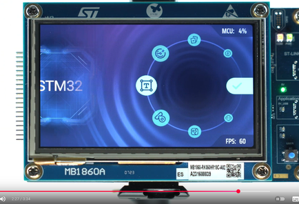

The YT video below shows Demo 7 with 'Font' example at 2m27s.
https://www.youtube.com/watch?v=MqBqnPLM-wM&t=147s
However the Font example is missing in Demo 7 in GfxDesigner 4.25.
Where can I find Font example please ?
Thank you

Hello @ferro ,
It is likely that we shared an alpha version for the video but ultimately decided to remove the text example from that demo, perhaps it wasn't displaying all the capabilities of the board.

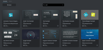

There are a few text examples available on TouchGFX Designer 4.25.0 :
Regards,
2025-04-14 9:17 AM
"There are a few text examples available on TouchGFX Designer 4.25.0"
Thanks for pointing that out, I searched 'vector' word as I would like to see how that effect of scalable text size in Font example was achieved.
I thought there is possibility to change vector font size at run time but I cant find API to do that. How else would that font size change be achieved ?
Thanks.
