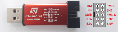

So all the ones that look like a USB drive are not original? I though the original ones also looked like that and that it was difficult to tell them apart
2025-11-23 1:01 PM
Take a look at the knowledge base article How to recognize a genuine ST-LINK/V2 versus a cloned one, which deals with this topic.
Regards
/Peter
2025-11-23 1:02 PM
The ones you get from official reputable suppliers are genuine. Other ones are likely not, especially if they are considerably cheaper.
There is no official product that looks like this, so they are all knock-offs:
The ST programmers are not particularly expensive compared to the chips. See STLINK/V3MINIE.
STLINK-V3MINIE STMicroelectronics | Development Boards, Kits, Programmers | DigiKey
2025-11-23 2:00 PM - edited 2025-11-23 2:10 PM
Next time, if you buy a cheap "clone st-link V2" , look at the user comments first, here at your device:
"probably Geehy APM32 S103CBT6 " .
So this will not work as st-link , because no STM chip inside.
