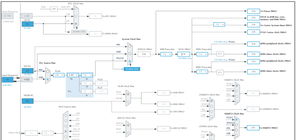

My clock tree is shown below:

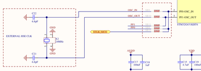

Thank you for your quick response. I've located the G431 NUCLEO board schematic here:
https://www.st.com/resource/en/schematic_pack/mb1430-g431kbt6-a02_schematic_internal.pdf

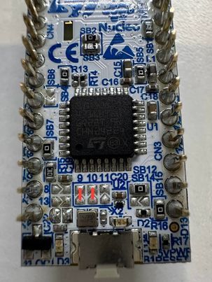

Upon reviewing the schematic, I observed that the clock signal can be selected between the STLink Master Clock Output (MCO) and the 24MHz external oscillator by configuring soldering bridges (shown in the screenshot below). The issue with the previous clock error stemmed from none of the soldering bridges being connected on the new development board, leading to no clock signal being fed into the HSE pin.
To address this, I plan to connect the SB9 and SB10 soldering bridges on the development board, as illustrated below:
Your guidance has been immensely helpful in identifying the root cause of the problem. I appreciate your support.

Dear @xlin.1
Can you provide the schematics and how the 24MHz crystal or 24MHz oscillator is connected to the HSE pins ?
Have a good day,
STOne-32

Hi @STOne-32
