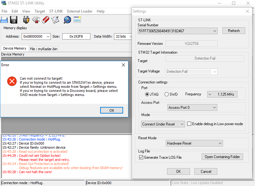

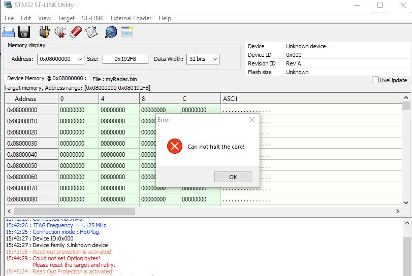

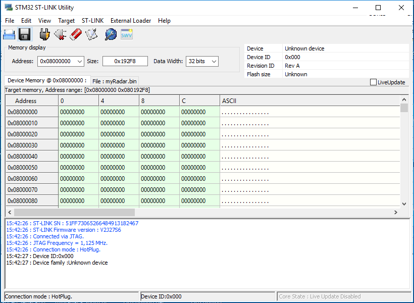

First of all, the only mode in which I can connect to the chip is HotPlug mode. I can't get any connection to the chip with normal or with connect under reset mode. I also tried pulling the reset-pin of the chip low/ releasing it when connecting. Also, in hotplug mode, my chip does not get recognized correctly.

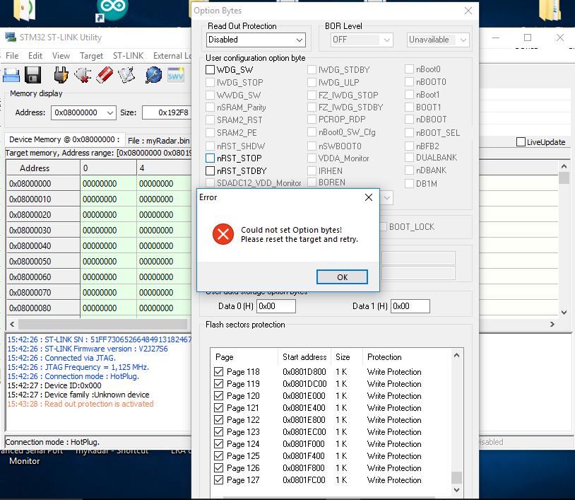

I tried erasing the chips content, (again also tried it when toggling the reset pin), but I always get the message ''readout protection enabled''. So I went to the option bytes menu and tried disabling it. However, this error occurs:
When I enter that menu while I actively pull down the reset pin, the page looks a bit different (e.g. distinct levels of readout protection). But I still am not able to disable the readout protection. In other menus, I often get the following error:
