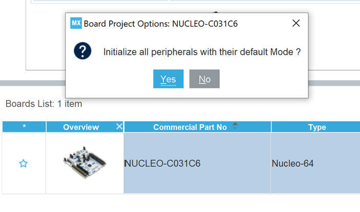

You require init right way
i click this and all is green
