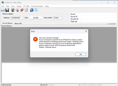

I have designed a custom board with the STM32G0B1CET6N but I cannot connect to the nucleo st-link programmer.
I have removed the two jumpers from the nucleo board but when connecting to the board it doesn't get recognised by the ST-Link Utility or STM32Programmer.
I do get an issue with the driver on the Device Manager but when I connect it to another custom board it works fine.

I have connected as your suggestion and now I do get a different error.
Need more investigation...I may get the board re-done with the VDDIO2 and VSS connected this time, just to make sure that the flying wires are not connected properly.
