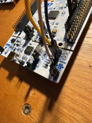

The link is working as normal with jumpers on, also it is working fine with jumpers off on another custom board (L010 chip). I have attached the picture with the jumpers off. I think I need to get a new board done with the VDDIO2 and VSS connected properly as the flying wire maybe are not connected properly. The board was factory assembled so I assume that is right.

For normal use you require three pins connected GND SWCLK SWDIO and on your image GND isnt connected
plus custom board power ...
