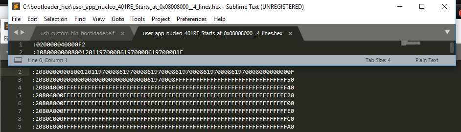

I am guessing I am missing some setting somewhere but I am not unable to find how to change how ST-Link Utility saves a readback of flash. So I am working on a bootloader application. My application is capable of writing the flash, I was just using ST-Link Utility to confirm that the flash was written correctly. Just to verify things a small snippet of code is supposed to write 4 lines of flash starting at address 0x08008000. Attached is the file named user_app_nucleo_401RE_Starts_at_0x08008000__4_lines.hex
I then can look in ST-Link Utility and see that flash has been updated and appears to match what my hex file contained.
Now I wanted to save this using File - Save file as. When I do this it saves the hex file but appears to write the hex file as 32 bytes wide instead of 16 bytes wide. I am trying to just compare the two files and because they are different lengths for each line I can't use a program like Beyond Compare to quickly compare the files. I can visually hold one over top of the other to confirm that they match.
My question is can I do something to save the file differently so that it matches my file that I started with. I want the file produced by ST Link Utility to make a file that only has 16 bytes of data in each line.

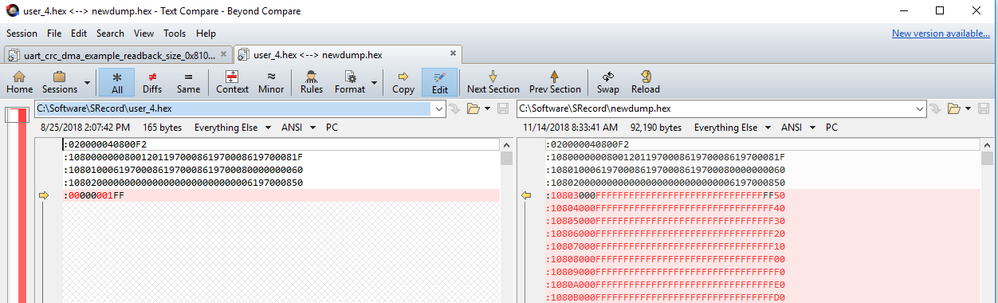

I went to sourceforge and found the SRecord application referenced. I downloaded the application, placed the file I wanted to examine (the file referenced as dump.hex from the support person), opened a command prompt and ran the command "srec_cat dump.hex -intel -o newdump.hex -intel -obs=16" as listed by support. The new newdump.hex file that was created was then compared against my initial hex file and it compared exactly correct for the lines of data that existed in my original file. The newdump.hex was much longer than my initial hex file (which was only 3 lines of data).
The program I used for dumping a comparison of the hex files was BeyondCompare from ScooterSoftware.
