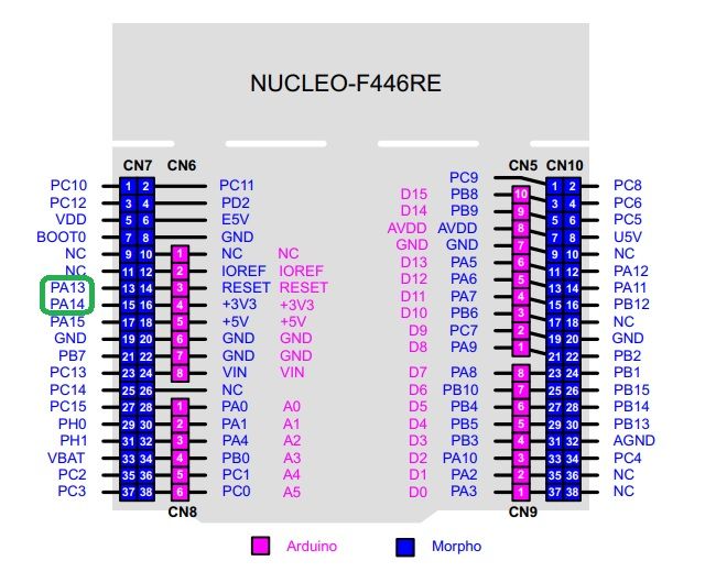

>> I can't find the signals for SWDIO and SWDCLK
Look for PA13 PA14, but as I said should be able to probe to the CN2 header

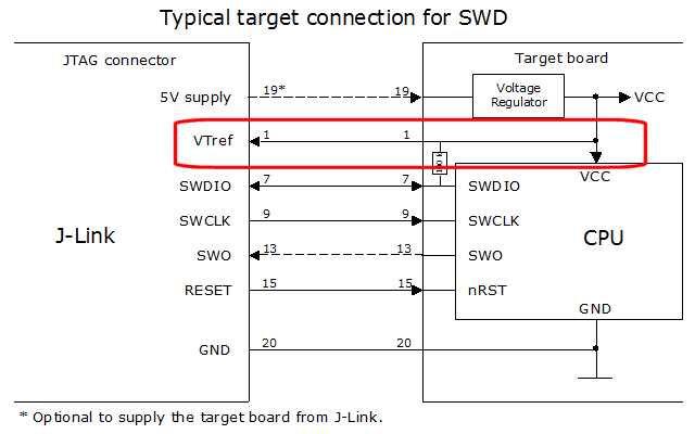

The J-Link also needs a "target voltage" reference connection. And, of course, GND.
https://wiki.segger.com/UM08001_J-Link_/_J-Trace_User_Guide#Reference_voltage_.28VTref.29
https://wiki.segger.com/UM08001_J-Link_/_J-Trace_User_Guide#Target_board_design_2
Also Take a look at the Nucleo schematics.

Yes, GND is connected. According to the pinout of the Nucleo's SWD-connector I have connected VDD (1), SWCLK (2), GND (3), SWDIO(4), and RESET (5). Here "VDD" should be what you name "target voltage" - but the target does not provide that voltage. Exactly this is my problem!

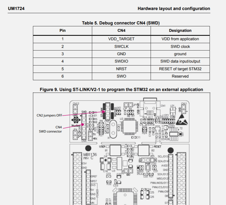

OK, I'm confused. What I'm referring to is this page out of the manual:
There I can find the pinout of this SWD-connector with VDD (documented but missing), SWCLK, GND, SWDIO, NRST. Thats exactly the pinout which is expected/used by the J-Link debugger.
On the other hand: the pins 1, 7, 9, 13, 15 and 20 of Neils image refer to what connector of the Nucleo? The ST morpho connector pinout does not fit (and while VDD, GND and RESET are there at some other pins, I can't find the signals for SWDIO and SWDCLK).

CN4 is an OUTPUT connector for the on-board ST-LINK/V2-1 (STM32F103).
You need to get to the SWD signals of the STM32F446, the SWDIO/SWCLK will be exposed on one side of the CN2 jumpers.

Who the fu** is designing such a poor board? So I have to collect the signals anywhere at the board? SWD/SWCLK at the CN2 connector (which pins?), GND and RESET at CN4 (or somewhere else?), VDD at wherever I find it?
