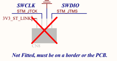

I had the stm32f746G-disco development board laying around, after while I wanted to try some application, during flash I got warning that my st-link firmware was old, I wanted to upgrade it but failed during upgrade, anyway it was very old firmware. Well I had another st-link at hand, I have connected it to the SWD port on the dev-kit, *** me I thought it is connected to stm32f7 but after pressing erase flash I saw the connected MCU is stmf103, well I accidentally erased the st-link, long story short it was a *** mistake.
I have been searching online there are lots of suggestion, I am very confused, is there a way to recover the on board stlink. Because there is no jumper or pin that exposes SWD/JTAG pins of stm32f7, I need to recover it.
I have tried "java -jar STLinkUpgrade.jar -d8_d32_msc_br -force_prog" with stm32f407 nucleo board but no chance.

Did you connect over CN8 connector?
That was a mistake indeed.
I don't think the STLINK is recoverable.
What I can propose is to use the solder bridges on the board:
Remove SB14 to SB17 solder bridges to disconnect the STM32F7 from STM32F103 and solder wires using pads from unsoldered SBs to connect through an external STLINK.

only chance to get the onboard st-link working again, is to flash a bootloader...then update to st-link.
You could try...otherwise just use another st-link, as mƎALLEm wrote . Onboard is no st-link now.

Simple tip buy cheap nucleo and swap 103.
2025-12-28 12:35 AM
Good idea to save the disco :thumbs_up: but for now I have soldered jumpers to CN8 and removed solder bridges; SB15 and SB16 and connect them to CN8 to be able to use external ST-Link
