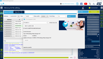

2025-12-27 2:11 PM
THANKS TO THIS TIP, I MANAGED TO RESTORE THE FW STLIINK FOR DK 1292D!!!
