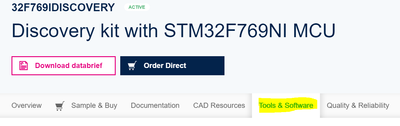

Here is how to download them :
- Please refer to the : https://www.st.com/en/evaluation-tools/32f769idiscovery.html#
- Go to "Tools & Software"
- At the end of the page you will find "Binary resources" and the "compiled demos"

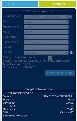

11:34:29 : Start operation achieved successfullyThis is the info about the target board in STM32CubeProgrammer which all looks okay to me. Annoyingly the UI hides some of the text behind "..."s. It shows that the external loader is there and it's found the parts okay.
The readme did say that for the media demos that I need to connect a USB stick with the provided media files on it, but I've had another dev kit board which still boots into the usual list of apps without needing this plugged in.
Are there any steps I'm missing in getting this board to work? Even doing a full chip erase first doesn't seem to have changed anything either.
