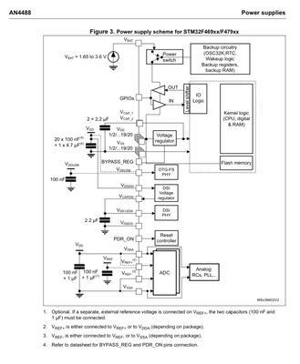

Welcome in our Community , Herr is a link for the minimum hardware setup required for STM32F4 series : https://www.st.com/resource/en/application_note/an4488-getting-started-with-stm32f4xxxx-mcu-hardware-development-stmicroelectronics.pdf
And below for F469 MCU :
To better help , if you can provide schematics around all power and dedicated pins in particular PDR_On, Bypass_Reg and VCAPxx pins .

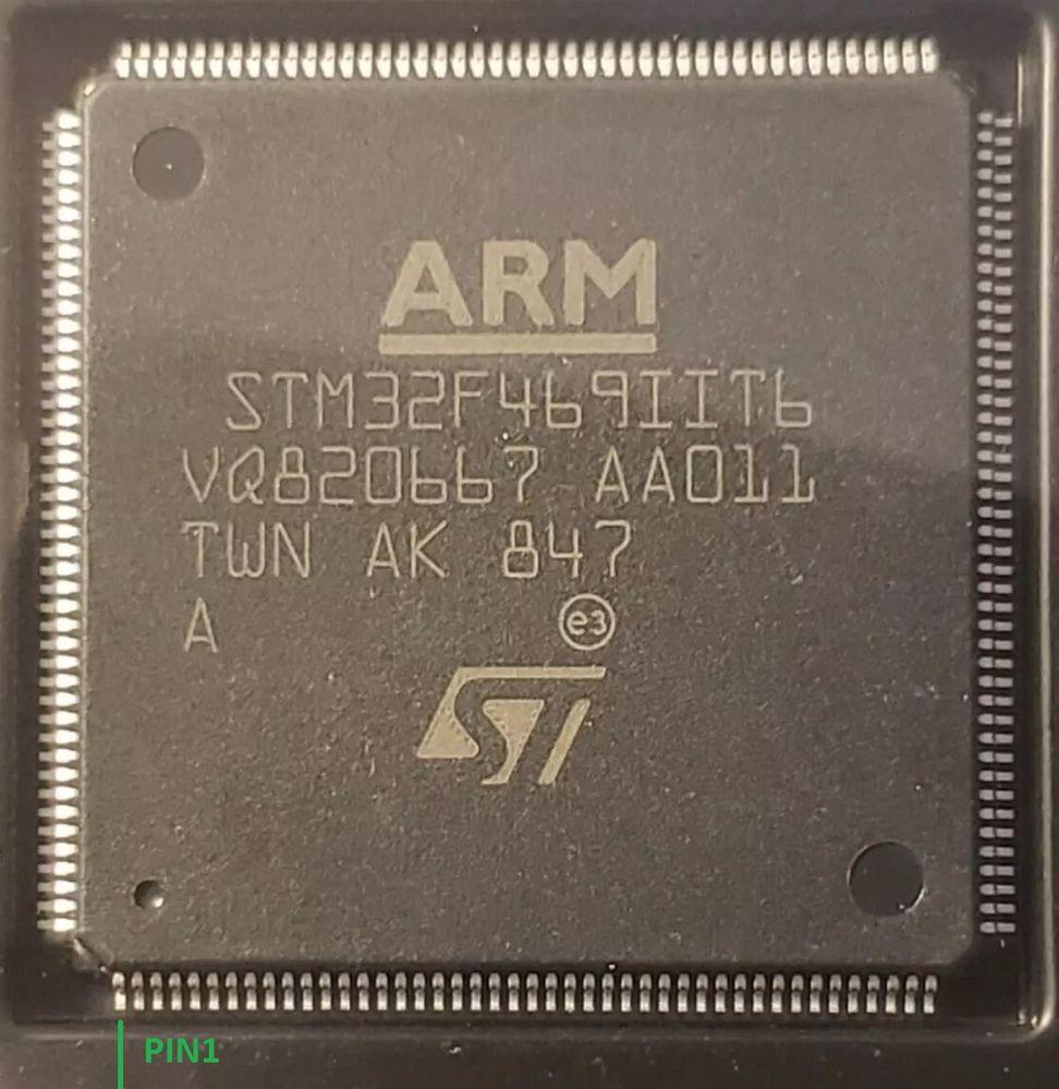

Check part orientation

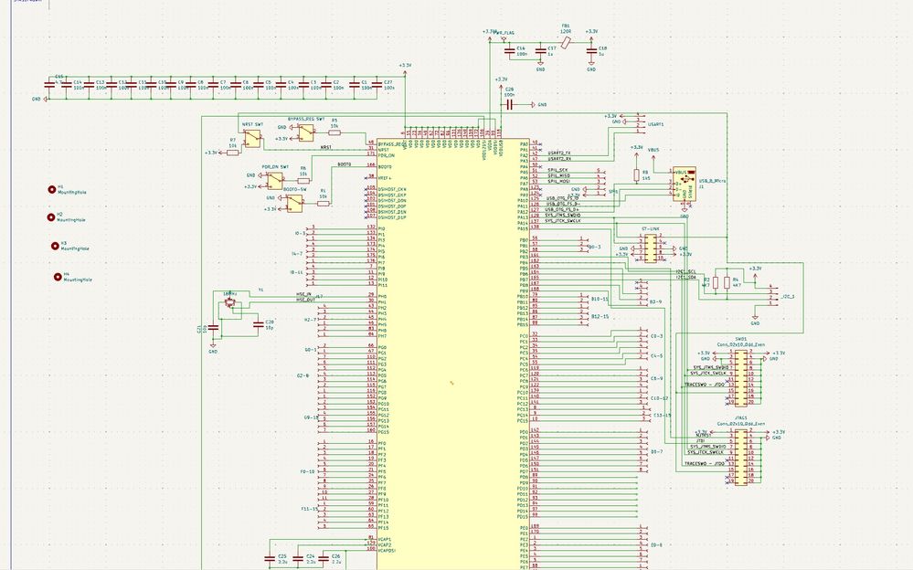

Provide a schematic, constrained to the STM32 if that's simpler, so we can better understand what you've built.

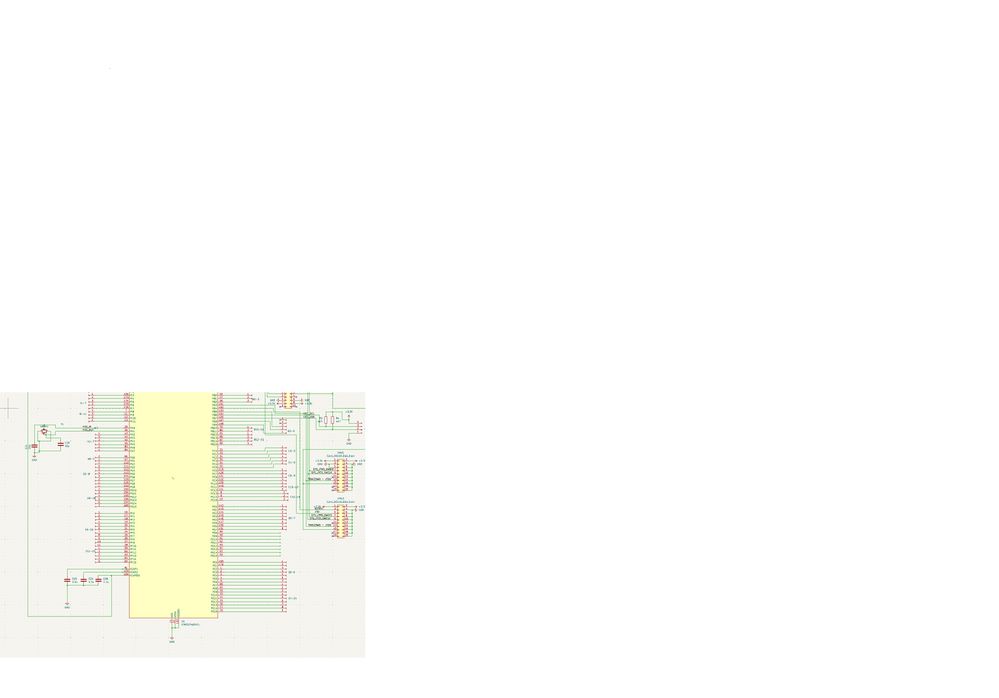

Hi! I've been following the diagrams, they really help! I bought an adapter, where I then soldered the MCU to be able to kind of work in the breadboard. I wired the pins in the diagram, but the ST-link did not find the target. I also got another ST-LINK as Peter suggested, and I thinking in manufacture one version, for I am wondering if the distance of the capacitors from the VDD pins are one of the reasons for my constant failure. I will post the schematic I have so far. Thank you very much!

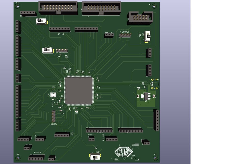

I was working on it today, and that's what I have so far... This the first PCB I have ever designed, so I appologize for any *** wiring. Thank you again!

Sounds like an orientation issue
