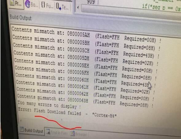

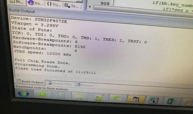

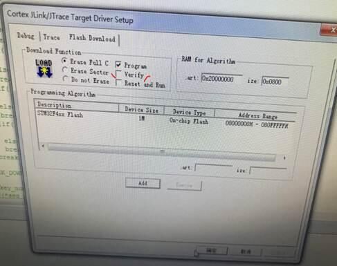

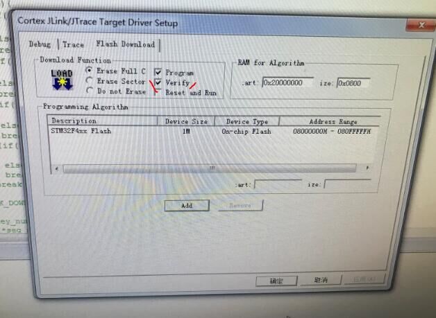

5. Simulator Connection Experiments:
5.1 Without checking, the software prompt can erase FLASH and burn chips, but the program just can't run. Nor can DEBUG be online.
5.2 Check the case: Software prompt can erase FLASH failure:
Because the Flasher does not rely external quartz oscillators of the target. The MCU is started up with the HSI as clock source.

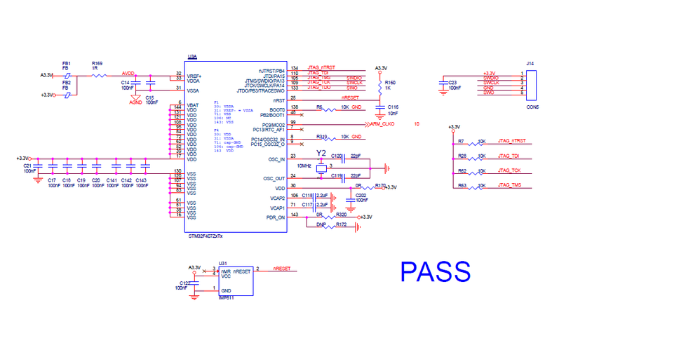

I am a software guy, my knowledge about particularities of hardware designs is limited. Hopefully, some hardware designers **** in.
Buffer caps for VDD seem there, and the wiring around the quartz looks normal.
As said, I would use a debugger, and verify if the MCU can properly start up clock tree from HSE. On a board that fails above mentioned procedure.
