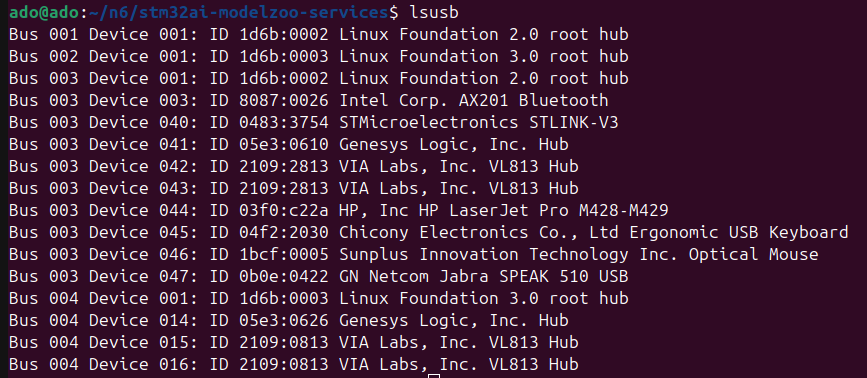

Tried on both Linux/Ubuntu and Windows with both CubeIDE and CubeProgrammer.

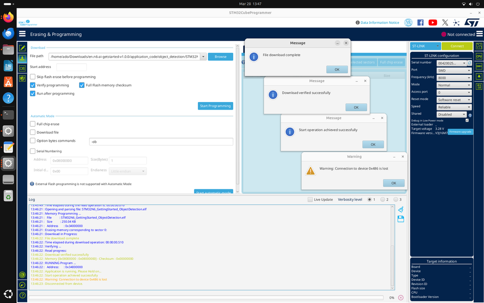

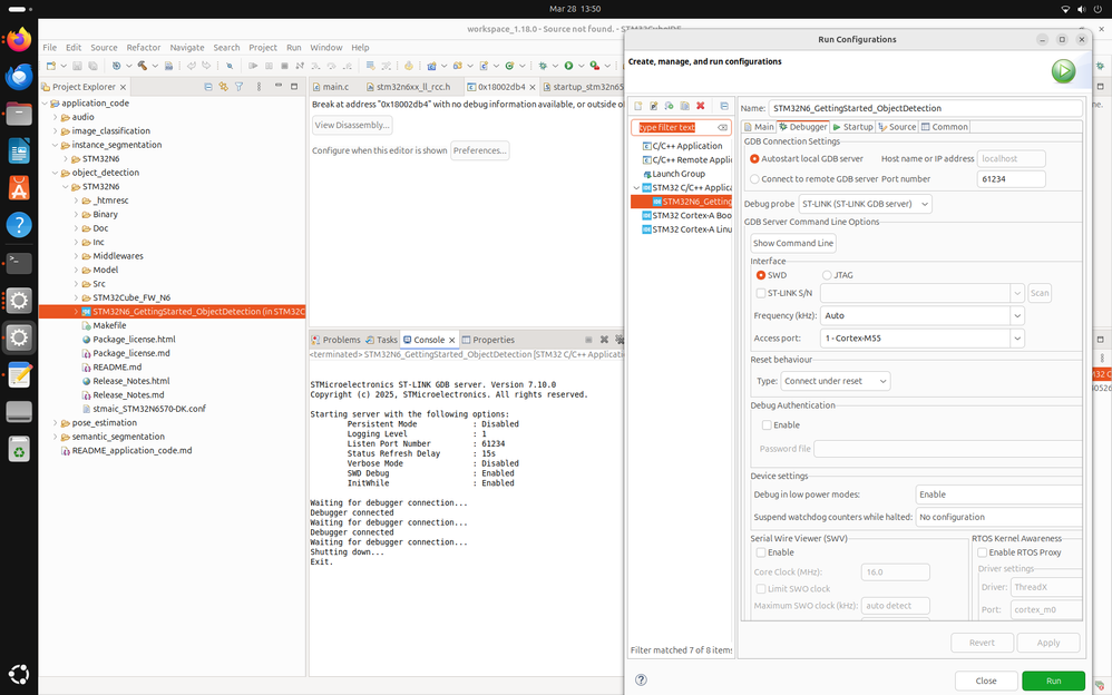

Drivers/usb seem fine but i keep getting a "Connection to device lost" on CubeProgrammer or "Waiting for debugger connection" errors when i try to flash N6 with new application so its not programming any new applications.
Tried with JP2 at position 1-2 and 3-4 with all different USB cable types too.
Happens when i select "Run after programming" on CubeProgrammer or hit B1 (Reset Button on DK).
Verbose CubeProgrammer Log attached, Any ideas ?
See at end of log "14:33:17:828 : Warning: Connection to device 0x486 is lost"

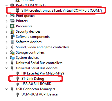

I had the same problem, & this solution resolved the powering problem. Is it acceptable to power the board via USB 1 with JP2 in the 3-4 position AND connect USB to a laptop for COMs? Thanks
2025-04-08 1:49 PM
Yes it is, it worked for me in the end that way. Powering on USB1 and comms only on the STLK one.

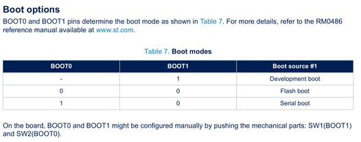

Hope that all worked, for me , one thing that threw me was when following this README to load the object detection to the DK,
and it says
"3. Set the switch BOOT0 to the right (dev mode) and disconnect/reconnect the power cable of your board."
i believe it should say BOOT1 and not BOOT0 ?
