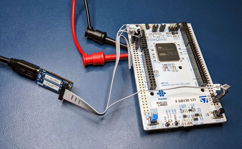

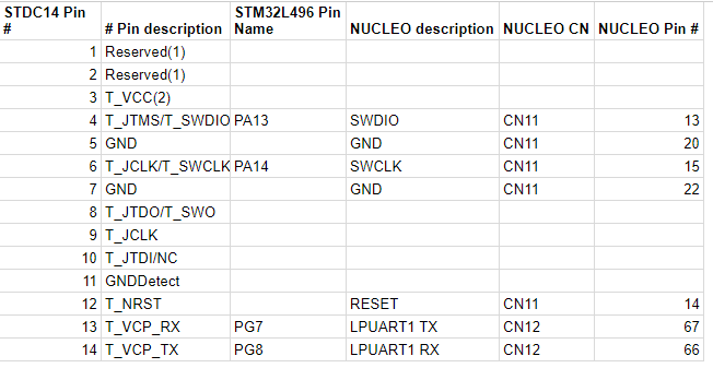

I wired up STDC14 for STLINK-V3MINI (STM32 JTAG/SWD and VCP) to the NUCLEO:
I'm powering the NUCLEO board with 9.0 V on Vin.
If I connect a USB cable to the V3MINI and try to debug in STM32CubeIDE, I get:

Probably a wirering mismatch. ST Link v3 mini uses 14 pin Mini connector. After saw off, you used ST Morpho connector? Did you check the schematic to make sure all signals are confirmed routed to STM32L476?
Make sure as this is the main difference...

Dumb, dumb, dumb! I had miscounted the conductors in the ribbon cable, and once I saw it that way, that's the way I saw it for the rest of the day. It is working now.
