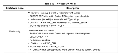

There is no difference in shutdown behavior, or low power mode behavior. They're the same chip in a different package. The difference must be due to other code or other hardware differences. Are you meeting all of the other requirements to enter this mode per the reference manual?
Put a while (1); loop right after the WFI to make sure chip is going into shutdown and is restarting after waking up.

Most chips have ADC and DMA capabilities in some low power mode. But if you have interrupt enabled, it will wake up when those are triggered. Probably this is what was occurring in your original post.
Low power modes are incredibly flexible, but they are also incredibly varied. You will need to determine the behavior you want and then choose a suitable low power mode for that. The reference manual goes into great detail here.
