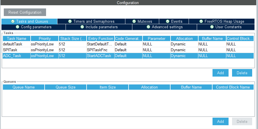

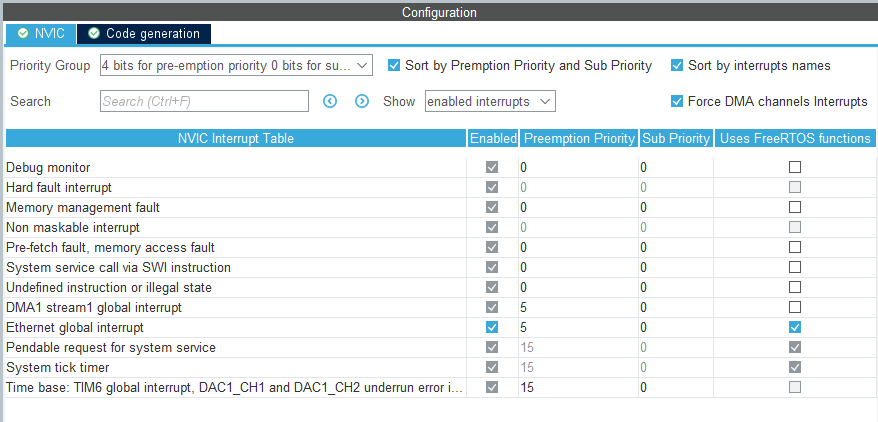

Following is the implementation of CubeMX.
This is NVIC Table of my current imlpementation.

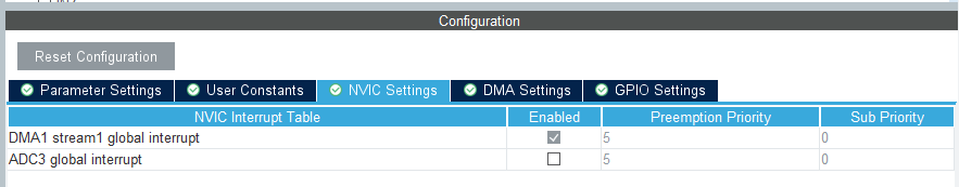

Following is ADC NVIC Part
These are the task configuration of my implementation.
Any help regarding this issue will be appreciated.

This is going to be a code issue/solution. You can give ADC processing a higher priority if you want it to run more often than the TCP code, perhaps process within the interrupt if it's high priority and quick enough. But there is no magic solution to running two codes at once. It sounds like this is an RTOS project. Context switching will have a cost, and keep in mind only one thing runs at a given time.
Hard to give more specific advice without seeing the code you're using.
