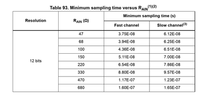

Ok, so next "problem" : you set very short sampling time, this works only on low impedance input.
-> read in ds...
and set longer sampling time or (if slow signal or DC ) a big cer.cap (100nF or so) on short connection adc-input to gnd.
If still "Getting oscillating ADC value" look with a scope on adc-input pin - maybe adc is right. :)

Sorry for the delay, I have increased the sampling time every steps up to 640.5 cycles but the still the ADC value is oscillating as earlier.
I have checked the Vref+ and VDDA pin voltage on scope and the voltage varies from 3.28V to 3.3V and On ground pin the voltage is zero but there is a noise with voltage of 80mV which is around 100 ADC count.
In Errata sheet of this controller, I can't find any issue on the GND pin.
