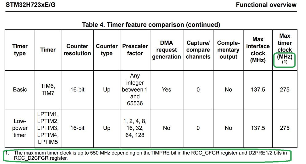

I am trying to achieve the maximum timer clock on the STM32H723ZG for input capturing. In the data sheet is written under Table 4: "The maximum timer clock is up to 550 MHz depending on theTIMPRE bit in the RCC_CFGR register and D2PRE1/2 bits in RCC_D2CFGR register."

What would HELP, is that the Foot Note on Table 4 NOT BE THERE if none of the TIM listed in SAID TABLE support 550 MHz
SYSTICK, nor HRTIM, are in that table, and Tilen's post is from SEVEN years ago, for a different processor/die
Fixing the documentation needs to be JOB#1, there's just way too much of this cut-n-paste nonsense that dwells for years. Need to hire some technical writers and proof-readers.

2024-02-13 11:14 AM
In the datasheet: https://www.st.com/resource/en/datasheet/stm32h723zg.pdf
On page 41

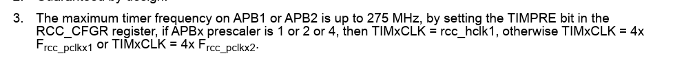

As indicated on the table, 4 of the datasheet, the maximum timers clock is 275MHz. But the Systick timer clock is up to 550MHz. The answer of this post may help you.
Best Regards.
STTwo-32

But the systick clock is different from the timer clock, right? According to the data sheet the timer clock should have 550 MHz.
2024-02-13 12:04 PM - edited 2024-02-13 12:06 PM
For counting elapsed machine cycles, perhaps look at DWT CYCCNT
Fantastically UNHELPFUL
2024-02-13 12:14 PM
See it as marketing gag : there is one timer, sys , that can run on core clk , 550M . All other NOT .
Except you set the D2PRE1 yourself ... overclocking . The timer should work at 550M...but what else works, or not, you have to test yourself.
