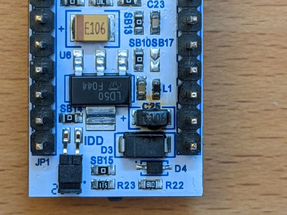

So I attached a 9V block to VIN and GND. It did not work, and all that happened was that I started to smell and got hot. It looks like the capacitor C25 was the component which got really hot.

Everything seems correctly hooked up as far as I can tell. Could be missing something. Definitely seems like C25 got fried. It's a polarized cap, so overvoltage or reverse voltage could fry it, but I don't see how that would happen with this setup. If I had a board I would test it for you.

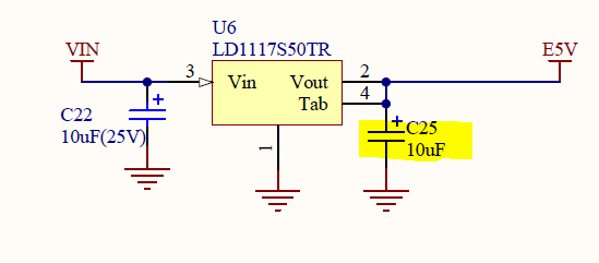

C25 is on the output of the 5V regulator and shouldn't have an issue with this.

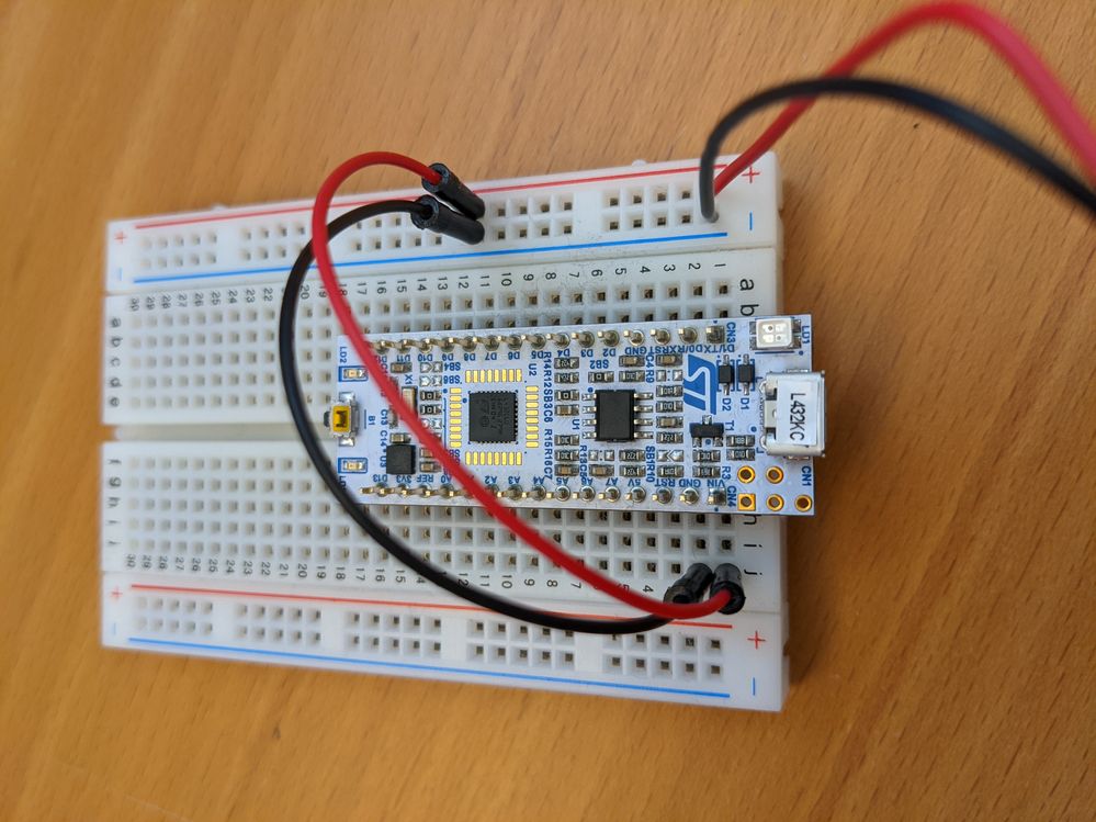

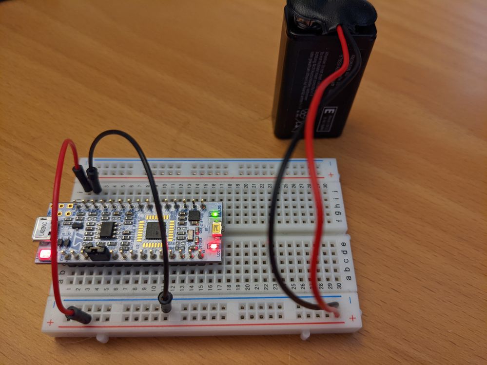

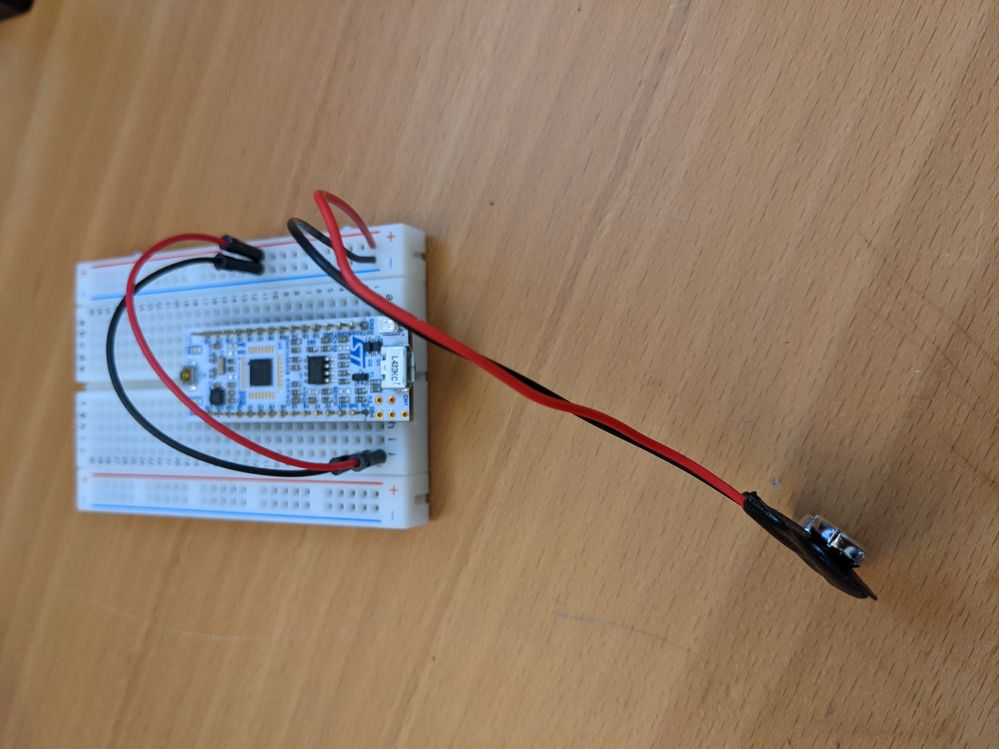

I am confident, but not sure :) Thought I did it correctly, thus my quest to find out what went wrong, and seeking help here. I took some pictures, maybe that helps.
Here is the component which I suspect got blown, looks like C25:
0693W00000BdMWVQA3.jpgHere is the overall setup:

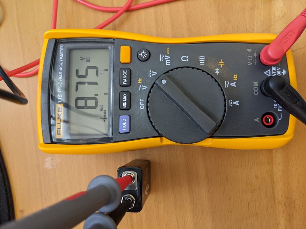

0693W00000BdMWkQAN.jpg0693W00000BdMWpQAN.jpgAnd a check that the battery is ~9V:
Should be ok?!
