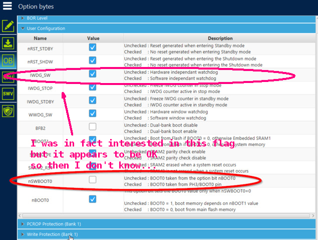

Followup: As the above solution actually fixed 5 out of 6 I stop it right here. As it happens I used exactly that one that still doesn't work. However, due to the symptoms I got little surpirsed that the BOOT0 issue solved all of it for the other 5 boards. And the IWDG issue only remains for the one board. But "one is none", consequently I accept this issue as resolved.
Now, lets continue.
What works now is, that it won't break my debug session anymore when a reset is caused for any reason. However, eventually the system still resets after a few milliseconds.

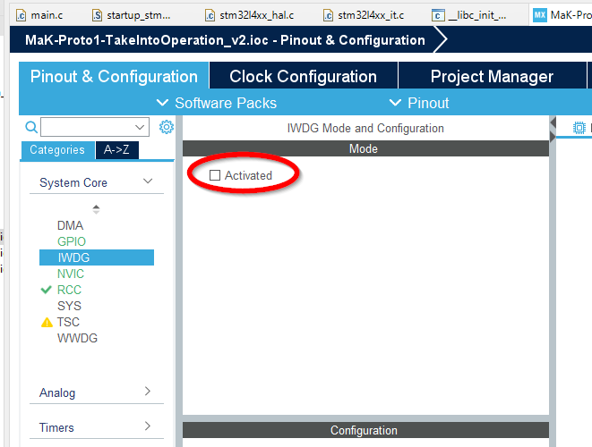

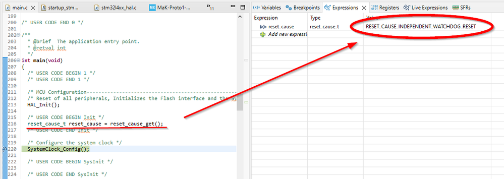

Using the approach of https://stackoverflow.com/questions/34196663/stm32-how-to-get-last-reset-status
to check the reset cause showed me that these permanent resets are caused by the independent watchdog (IWDG). But this shouldn't be possible as it is not activated.
?? Any explanation for this?

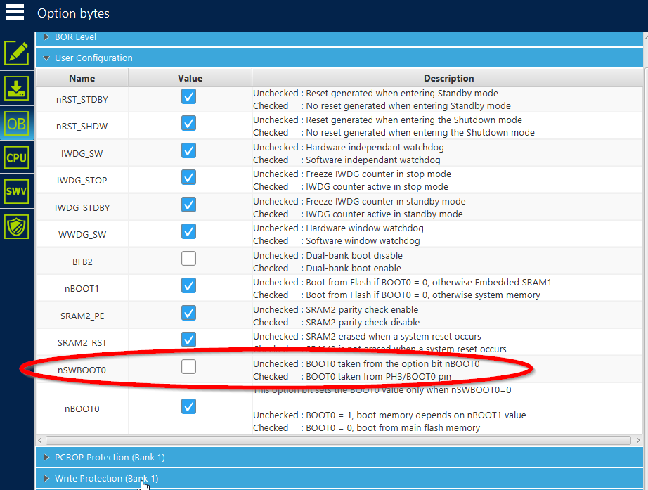

2022-11-11 2:24 AM
Show how did you set the option bytes.
2022-11-11 3:56 AM
I deselected the nSWBOOT0.
