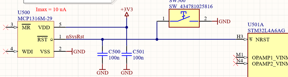

I can also measure the NRST (Pin H3) line that is pulled down caused by any internal mechanism (Unhandled interrupt?).

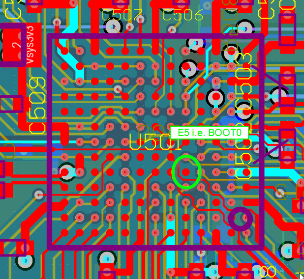

thx also for your input. This made me check AN2606 and thinking of whats happening if this pin remains floating (which it does, it's not connected anywhere). How ever, as certain boards work reliably and certain reliably not, would fit quite well into this pattern. But would I then be able to debug a single line of code at all? So far, trying to debug it eventually works for a few lines of code until I reach the above described code section (I can provide further details to this if required).
So, somehow yes, but also no. Having it floating I understand that this has to be corrected (pulled up or down)(true?).
... eventually I need anything to be certain what the cause is before I ordere an other batch super expensive boards.
? :dizzy_face:
2022-11-08 8:16 AM
> The boot pin is floating
That is the cause of your problem.
Fix it on the existing boards. If you're lucky, there may be option bits which disable the BOOT0 pin. I don't use the 'L4+.

Hehe, "UN"fortuantelly its a 169 pin BGA :> Nope, I made already many electro-surgical intervention to inner layers, but I don't think so that I will be able or nearly successful to get to that pin from the other side.
For sure this is an issue. And it (maybe) explains the issue I have, when starting up the boards that actually work (i.e. when powering it, even with having a voltage supervisor that releases the reset pin not before the voltage reaches 2.9 V, I have to pull down the reset line manually with the attached reset button).
But how would you explain, that I still can run the debugger and run a few lines of codes? I mean, now having this pin floating the uC eventually will detect it as either being "high" or "low". Consequently I would either be able to run it fully functionally and maybe when turning it on a second time it wouldn't work at all, as the BOOT0 eventually makes it decide where to search for the program to run. Wouldn't you agree?
Sorry for insist for further explanation and not simply check that first. The problem is, that I'm unable to rework that on the current board (as visualised above) to check if that helps. I will have to order a new design having this BOOT0 fixed. But as this is going to be expensive in any case, I would want to find a plausible answer to all symtoms before spending the next batch of money. I hope you understand.
