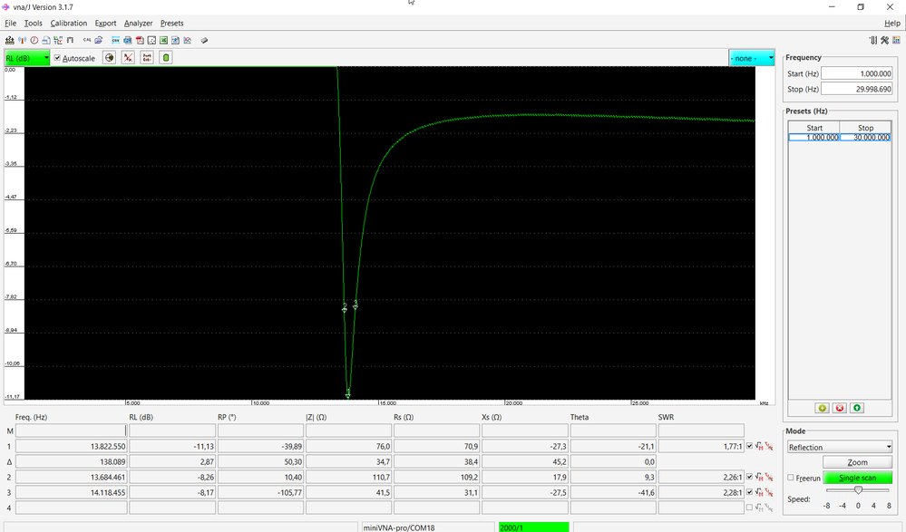

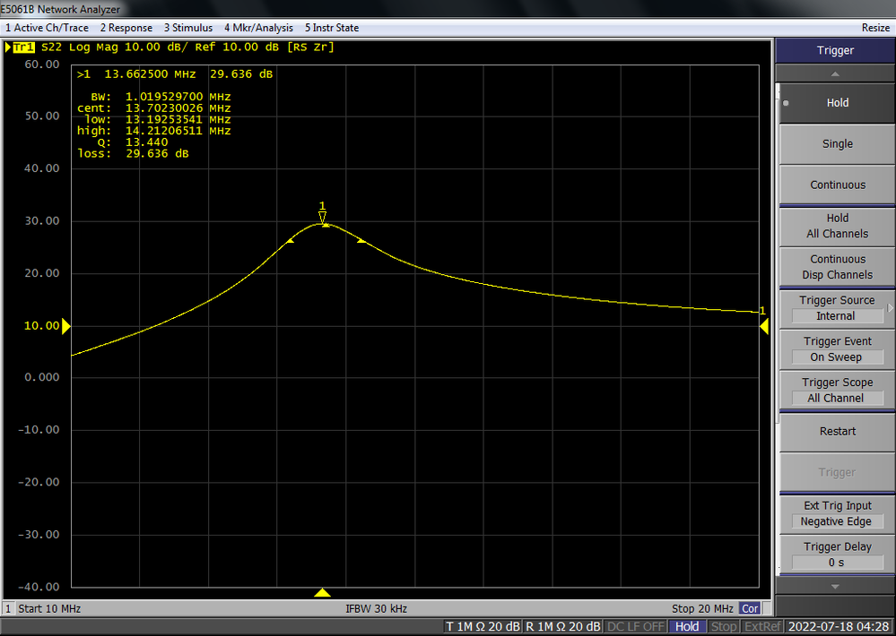

Hello Ted,
I typically use Keysight scopes with quite some memory to observe a few frames in the analog graph.
My software colleagues use a Picoscope 3000 series to capture mixed signal traces (SPI communication + RF field capture.
They also use digital analyzer to only trace the SPI communication.
I have captured two traces: first one is taken with our Keysight VNA:
The second one is captured with the miniVNA pro:
You can use this pictures to compare the two results. Both use the same antenna and same tag on top.
The miniVNA is missing the Z-conversion. But i assume you can export the S-parameter and do the conversion externally.
br Travis

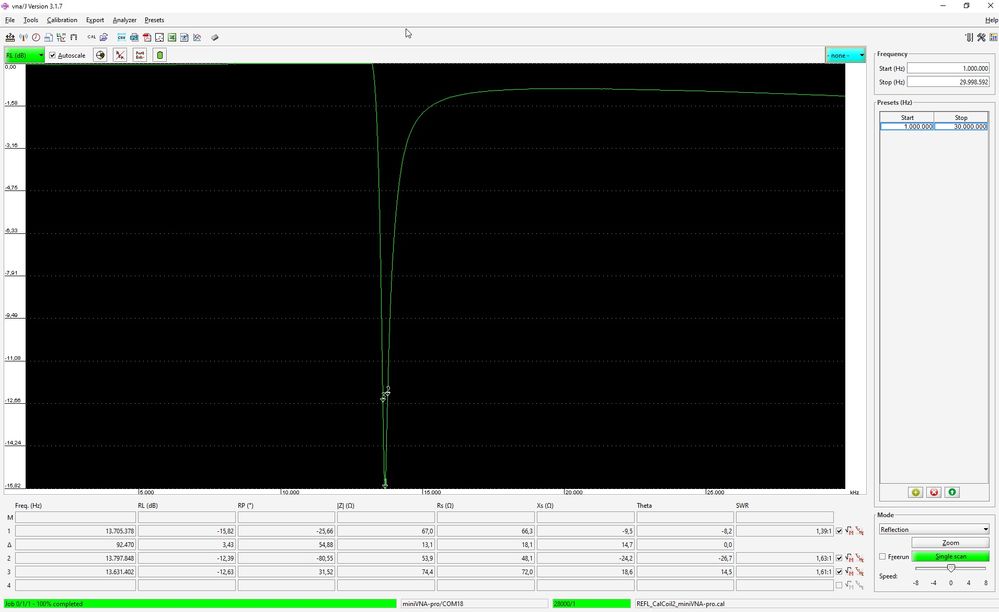

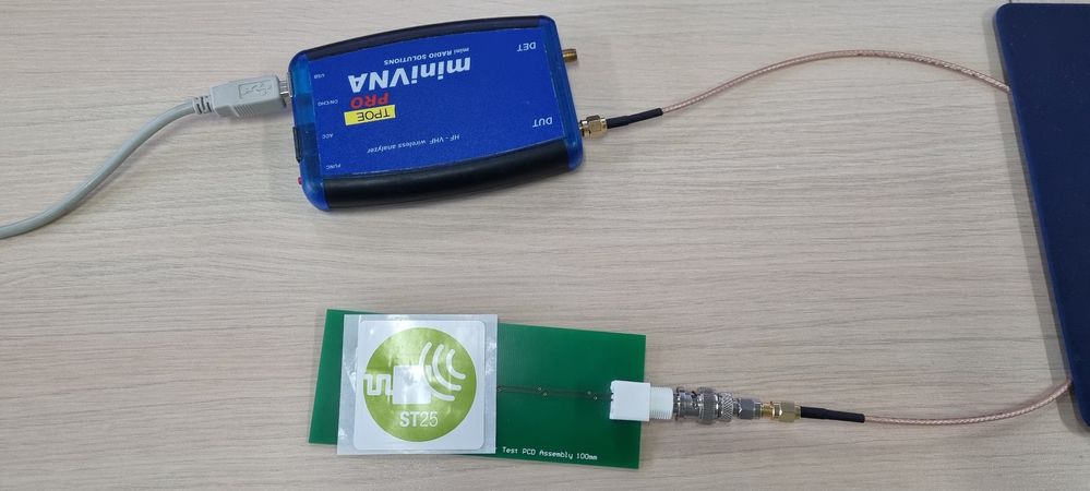

2022-06-24 7:16 AM
Hello Ted,
i had another look with my colleague.
If you replace the short during OSL calibration by the antenna, you can sense the resonance frequency of the tag.
I can crosscheck the results next week, once I have access to our VNA again.
Below a picture of my setup + measurement result.
br Travis
