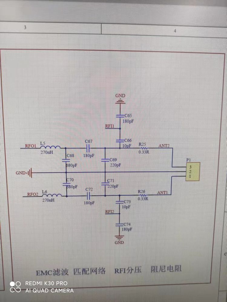

I am using ST25R3916 to make an RFID reader, but I don't know how to calculate the transmit power of its antenna. I am using a differential antenna design, as shown in the figure below:
Hope to get somebody's support.
