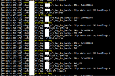

So far as I can tell, the timing is all good. The IRQ comes in within a millisecond of "LM respond" in the below screenshot at 15.009,033. Then we read, and the transmit process completes at 15.012,145.

yes, as said, basic procedure looks fine - sending using FIFO + Transmit with CRC command. Not sure about the timing - the time stamps are not fully clear, when the PCD frame has been received, could be in the 4ms range. At such level also Logic analyzer traces with SPI+IRQ would help a lot. Potentially also observation mode tana=5 and observing TAD1/TAD2 or CSI/CSO.
