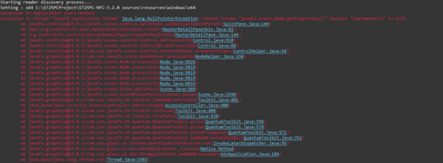

I have downloaded the source code of ST25PC-NFC (STSW-ST25PC002) and tried running it as it is. I am running JDK 23.0.1 and also downloaded and extracted JavaFX 23.0.1. Every time I run the MainApp, it loads the application for a second before it gets closed. I get the following exceptions (screenshot attached).

Could you please perform those checks in the Eclipse Run configurations?

Hi Damien,
That works. Thank you for the help.
