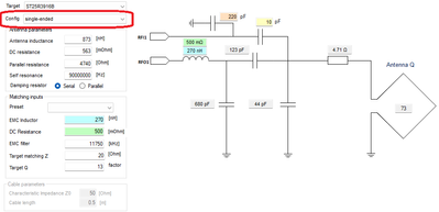

4.) I would recommend to follow the design process in AN5276. In the AMT (Antenna matching tool) you then can simply select "single ended antenna":
Please let us know, if you have additional questions.
