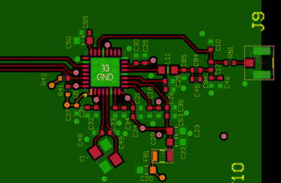

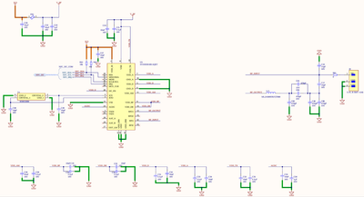

I am new to NFC and have designed the schematic for NFC reader and antenna based on ST25R3916B. I am connecting these 2 PCBs with UFL connector antenna cable. When i started to test, some how it did not work, meaning tag is not detected. Can you pls review my design and suggest what changes should i do changes in BOM to have matching circuit and tune the antenna so that i can get the signals when tag is detected.
Below is are the schematic and PCB images attached here for review. I would appreciate if i get any reply at the earliest.

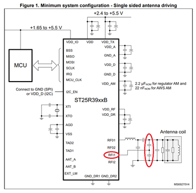

Since I am using antenna on a different PCBA, so I have used reader in a single ended mode and used RFO1 and RFI1 for transmission and reception.

I have seen two things that need to be considered:
For comparison the schematic stated in the AMT:
2. The decoupling pair at VDD_AM requires the chip to be operated in ST15R3916 mode.
Please have a look at AN6313, chapter 4 Device behavior after power-on and VDD_AM capacitor usage.

Hello Dilip,

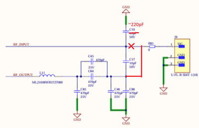

The NFC reader schematic seems just to be a blank page.
From the Layout i noticed that the capacitive voltage divider is missing, please check this part of the schematic.

Hi Travis,
Pls find snap shot schematic. I have checked voltage divider is there . Pls see below in snap shot
Pls find below answers for your queries
yes 3.3V is okay on all pins as expected
Yes power consumption as expected
I am using I2C which works well.

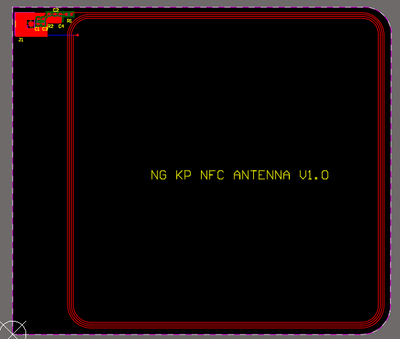

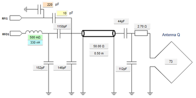

Yes I have designed the antenna and its matching circuit as per AN5592
I dont have network analyzer , so can not create smith chart.
I just want you pls check my schematic for antenna impedance matching network and tuning circuit on antenna PCBA.

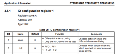

Also can you pls help what register configurations I have to do for single ended mode with cable and detection of ISO15693 complied tag.

Hello Dilip,
