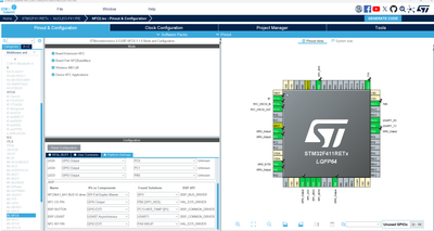

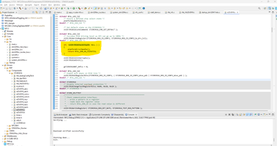

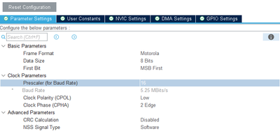

2025-03-03 11:22 PM
Hi @Brian TIDAL
Thanks, I have configured and tried running the sample application using SPI approach but there is some execption or error fault and stuck here. Please help.
Below I have attached the configuration and code snippet where the error is caught.
Best Regards,
Akash
2025-03-03 11:34 PM
Hi @Brian TIDAL
By referring to other tickets. Got the issue it was related to edges and clock rate after changing it is working.
I will check other operations and get back.
