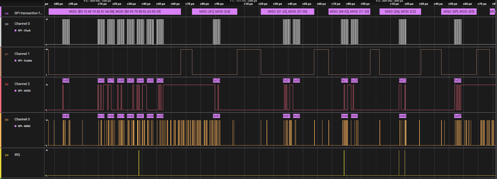

2025-02-28 1:04 AM
2025-02-28 4:08 AM
your session2 shows no 57h frame after IRQ went high again. Potentially your ISR not triggering or your SPI abstraction having an issue when IRQ rises during normal register access. Could be a there is a problem in your platformProtect...() macros.
BR, Ulysses

2025-02-28 6:56 AM
Hi Samman,
just again do a logic analyzer trace.
BR, Ulysses

Hi Samman,
I find in this trace:
P.S.: I have enabled the SPI transaction framer which make it easier to navigate the traces. It makes it easy to see e.g. all FIFO writes which are starting with "0x80".
BR, Ulysses

2025-03-04 12:09 AM
Hi Samman,
I have named the two states, locate them and put breakpoints. The next state after RFAL_TXRX_STATE_TX_TRANSMIT should be RFAL_TXRX_STATE_TX_WAIT_TXE. Find out why it isn't.
Ulysses
