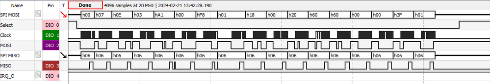

2024-02-23 8:16 AM
Hi Brian,
I am still working to get a trace that includes IRQ_I and IRQ_O but I can at least share the SPI communication from boot.
This device has some pretty cool features that I didn't know about and I hope I can figure out how to capture the IRQ lines with the SPI soon.
Does the attached txt file help you to help me?
Thanks!
-Andrew
2024-02-23 8:34 AM
the trace shows that last frame (the Idle command with DacDataH = 0xFC) is incomplete: the last byte is missing.
Make sure to send the proper number of bytes.

2024-02-23 8:56 AM
Wow, I see that now. I had an error in the for loop that cycles through and sends the array containing the string of data for that second step of the Cal rouitine.
Now I get a result of 0x98.
The datasheets say that the dev board would likely use 0x64 for DacDataL and 0x74 for DacDataH. Going off the recommendation of a 0x08 guard band, I would be at DacDataL of 0x90 and DacDataH of 0xA0.
Is that high for using the X-NUCLEO-NFC03A1 dev board?
