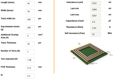

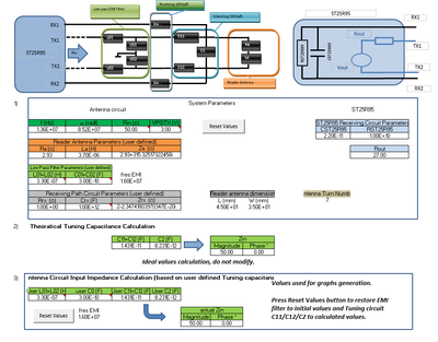

I am designing a custom board using your ST25R95 chip. To design the matching network given the antenna parameters, which I show in the following picture:

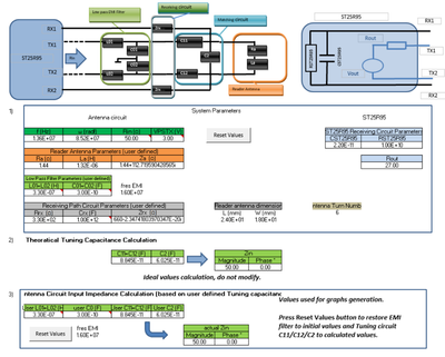

The tool you recommend (ST25R95_EMI_FILTER_CALCULATION) for the matching network returns me negative capacitance values. To overcome this problem I chose to reduce the value of the resistors on the receiving path. This is something I have not seen done in any other example so I was wondering if it is permissible to do this (changing RRx from 330 Ohm to 1 Ohm). I attach the screenshot of the output of the matching tool:

I've discussed with our RF experts. From mathematical point of view, adding a 1Ohm serial resistance would work but this is not realistic. They rather suggest to remove 1 or 2 turns to reduce the inductance under 2µH vs 3.7µH currently (which is too high according to their expertise). Having an inductance value under 2µH will give more freedom to adjust the Rx pin voltage under the 9V limit.

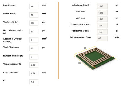

As in the previous question I am going to share with you the characteristics of this antenna:
this is the same antenna we are using for the tag so the two antennas (the reader's one and the tag's one) have a perfect geometric coupling. Unfortunately, because of the plastic between the two antennas, the reader struggles a bit reading the tag and can only do so in some specific relative orientations between the two antennas.

This is the matching network suggested by your excel tool:

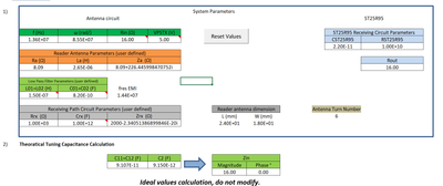

I imported into Excel sheet that gave me back this circuit:

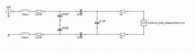

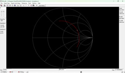

So I imported into RFSim99 to simulate it in the 13MHz to 14 MHz
Still, I am quite confused cause I got this as output:
Can you help me understand what is going on here?

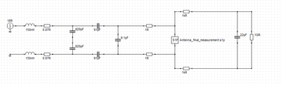

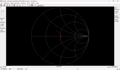

looking into the various AN available I found that this is the circuit I should have simulated (to account for the feedback network):
ant this is what came out:
but still I have some issues with the antenna parameters (Rant semms to be too high wrt the values obtained by the simulation). I will perform other measurements using the VNA (changing the setup maybe). Even though I am quite sure of what I am doing cause I am moving the calibration pkane as close as possible to the antenna.
Do you have any guess on what can be wrong with my approach?
Thanks for your time,
Luigi

I assume your latest screenshot is similar as Figure 10 of AN5248 Rev 1.
Only the frequency span is not as big as in the application note.
What you are plotting in RFSim99, is it based on simulation or is it based on antenna measurement s1p?
Can you directly compare simulation and measurement?
