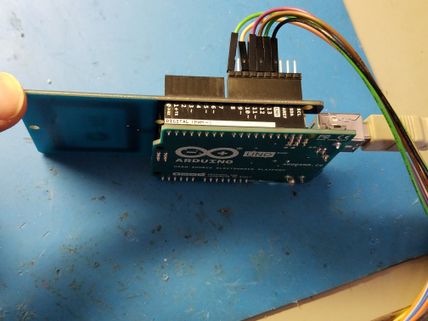

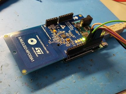

Can you share a picture of your HW setup? Is the X-NUCLEO-NFC03A1 antenna covering some electronics part of the Arduino board?

2024-02-26 12:04 PM
Hi Brian,
That is correct, I didn't realize that the field has to be OFF before going into Idle mode. I was trying to go into Idle mode when protocol was set to ISO14443A. I will add that.
Here is my development setup:
There is nothing below the antenna, so I wouldn't expect any effect of the UNO on the antenna.
