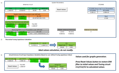

Hello
I have download the ST25R95 EMI FILTER CALCULATION.xlsm,but I observed that I'm a little bit unproductive

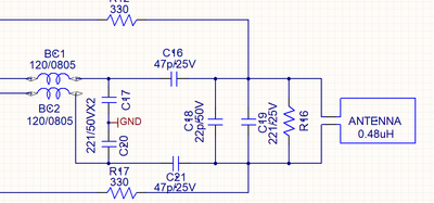

This is my part of the schematic, could you help me take a look, thank you so much

I'll add a little something,My board has an antenna coil turn of 2, which is a 46mm square。

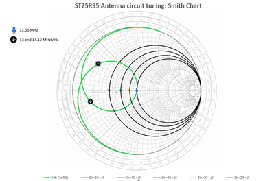

Based on the antenna parameter you defined (0.48uH), different Low Pass Filter values and some tuning in the matching circuit are required.
According to your inductance value, try adapting similar Low Pass Filter values as described in the Application Note: AN5248. Additionally, tune the capacitance values of C11, C12, and C2 to achieve a similar impedance chart as shown below:
I hope this helps with your matching circuit.
Regards,
BV

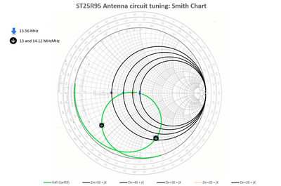

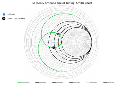

2025-01-17 4:24 AM
Based on your inductance value of 0.46uH, I populated the respective values from your design into the Excel calculation tool, and this is what I obtained:
Following the steps from the application note, I replaced the inductance value, and the chart looks like this:
From your matching network, try to modify the following:
The tuning frequency can be adjusted using C2, and the impedance magnitude can be adjusted using C11/C12.
BR,
BV
