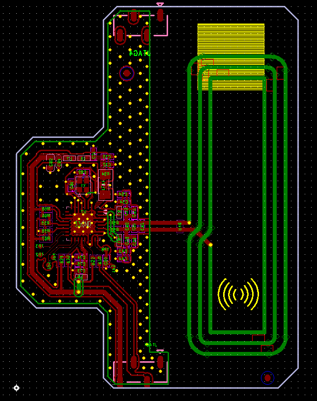

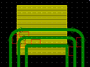

By the way, what is the yellow square under the antenna?

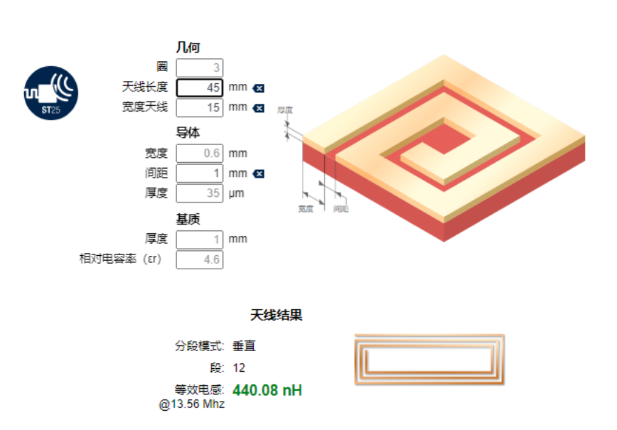

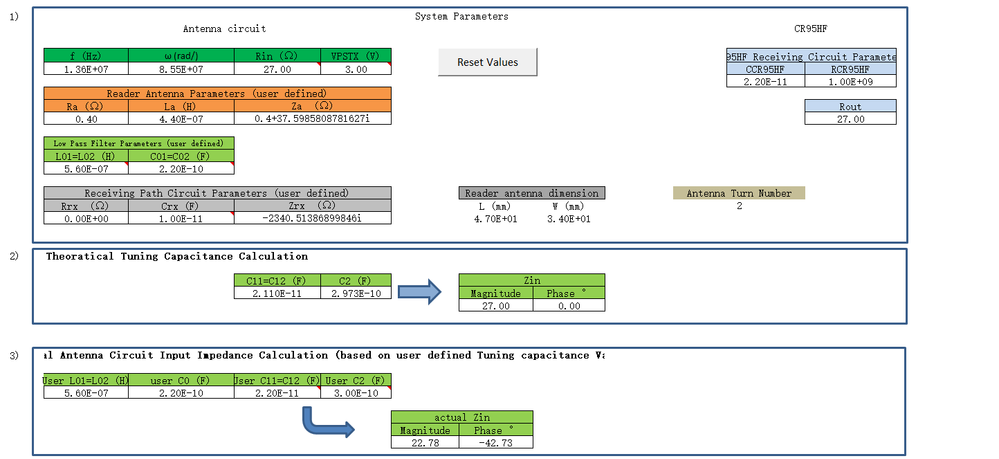

Also ,this is the design parameters for your reference

from the Logic Analyzer trace, I see that an ISO14443A REQ message is sent (REQA value is 26h sent as 7 bits message in the 04 02 26 07 SendRecv frame). The reply to this SendRecv is 90 04 01 A1 00 00 which means that an incomplete byte has been received whereas a 2 bytes response should have been received (typically 44 00 or 42 00). This is probably due to a matching circuit issue. Make sure to follow the "Step by step procedure" described in the Application Note AN5248 (ST25R95 transceiver antenna tuning circuit with EMI filter).

Hi Brian
It woks!this is due to mismatch of parameter,now I can detect FeliCa .
