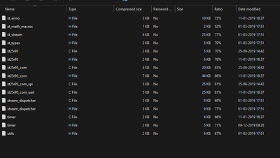

The X-CUBE-NFC3 zip I downloaded (v2.1.0) does not contain the CR95HF driver (Drivers/CR95HF folder missing). The package claims to support CR95HF for STM32, but only ST25R95 files are present.
Impact:
Cannot detect ST25TA tags using X-NUCLEO-NFC03A1 (CR95HF mode).
Request:
Where can I find the official CR95HF driver for X-CUBE-NFC3?
Is this a known packaging issue?
Alternate solution to read ST25TA with STM32F401RE?
Steps Tried:
Re-downloaded X-CUBE-NFC3 multiple times.
NUCLEO-F401RE
X-NUCLEO-NFC03A1 (mounted directly on the board)

ok, I see your point. As explained in the link provided in my first answer, CR95HF and ST95HF devices are part of the ST25R reader family as ST25R95. Thus the driver is the same for all those devices i.e. st25r95 driver available in X-CUBE-NFC3 is the one to be used with the X-NUCLEO-NFC03A1.

sir that is working and it contains that but what i wanted is library that can read and write
