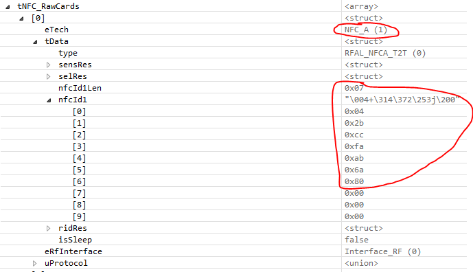

I can read the NFC-A ID tag with no problems from 50 mm distance (NFC Detection() + NFC CollisionAvoidance() ).
See screenshot below.
But then, when I try to activate the card and read the content, it fails: Reads all 0x00.
But not always: Typically I can read the card content after a reset of the MCU. But it is a bit tricky and the distance must be be within a very specific distance. And sometimes the data are not completely read.
After this first read of the content after reset, it fails 100% of the times.
There are no error during the execution. All calls to the RFAL library returns OK.
But all data are 0x00.

I am unsure about root cause, if it is digital or analog. Reading UID up to 5cm sounds like analog is ok. but being able to read the card only in specific distances sounds again analog issues.
Please start with and logic analyzer trace of SPI + IRQ - record the complete sequence of reading possible up to reading only zeroes. You can post it here - I can inspect, it often tells a lot.
