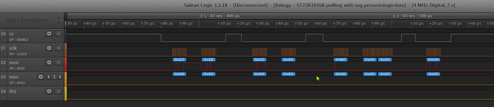

I ported the porting example to a different processor. The self tests are enabled and initialization passes. However I'm not able to read a tag. Logic captures (Salae) are attached. I've verified that I'm receiving interrupts and processing them. I also tested this hardware with an externally NUCLEO-L476RG board and off the shelf firmware and it could read the tags fine. Tags are very close to the antenna, within 1cm.
I noticed that when a 14443 tag is present, the number of interrupts increase, from about 15 per second without a tag, to 20 per second with a tag. But it never outputs the UUID of the tag itself. In the captures I observed that the interrupt gets serviced in about 20uSec.

here there seems a problem in your SPI implementation:
Here should be the sending of REQB(RFAL_NFCB_CMD_SENSB_REQ) command (3 bytes 0x05 0x00 0x00). The TX length is correctly written: 0x18 which means three bytes but on writing the FIFO the first byte is not there. Similar I found everywhere in the trace: The st25r3916WriteFifo() does not cause sending of the correct bytes, sometimes the first one missing, sometimes the second and basically always shorter. I suspect and issue in the platformSpiTxRx() but please debug starting from st25r3916WriteFifo().

Hi Derek,
the Salae seems to be configured @2MS/s which is too small to properly sample the 1MHz SPI. Therefore, some clock pulses are missing and the SPI decoding is affected by the missing pulses. Would it be possible to provide a new trace with higher sampling rate?

2023-02-10 10:59 AM
See attached. I checked through the bytes read and they look correct. Oddly I wasn't able to capture this fast a very new gaming PC, but instead a 10 year old Mac could do it.

2023-02-13 9:24 AM
Thank you, this is very helpful. Do you happen to have logic captures of what the initialization should look like? If not then I can hoop up the dev board and try to capture it, but I figure ST might have a gold standard reference that we can use to compare to.

2023-02-14 6:10 PM
