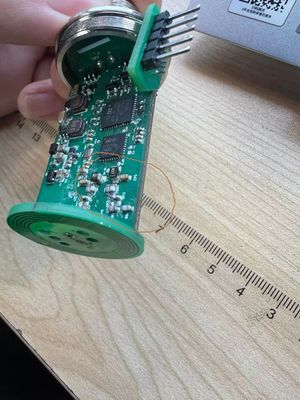

2025-02-06 1:42 AM
Hi.
I use my own custom board.The IC is ST25R3916.The matching circuit is vertically close to the antenna. When I keep the antenna away from the matching circuit, there will be fewer errors.The circled part is the matching circuit.
2025-02-06 2:28 AM
on our demos I don't experience reduced read range of the fast commands.
It sounds like you have a noise floor which affects the sensitivity. When using normal speed (26kbps) one reporting period is twice as long as for fast commands and I suspect that the longer duration will filter most of your noise floor.
I would start looking at receiver signals on CSI/CSO or TAD1/2 using tana modes to assess the amount of noise there and see which changes on your board help to reduce it.
BR, Ulysses
