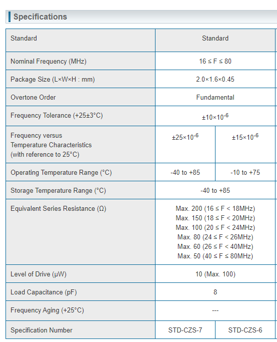

Lets maybe focus on a actual example:
Looking at the NDK hompage i have identified a suiteable crystal: NX2016-STD-CZS-6. It has the following specification:
For calculating the load cap it would mean:
CL = [(C1*C2)/(C1+C2)] + CS + CIC => C1,2 = 2*(CL - CS - CIC)
Where CL = 8pF, CS = 1pF, CIC = 2pF
C1,2 = 2* ( 8 - 1 - 2) = 10pF
The crystal we used has the same load capacitance specifications.

Hello Gaston,
