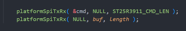

I finally got the library to work. The issue was caused by NXP's way of implementing the SPI protocol. It turns out that within the library, there are a couple of instances where Tx and Rx are done in two separate transactions. This works great when you have control over the CS line, but since the NXP SDK controls this line with each call to their transmit function, both instances were being treated as two different SPI calls.
Given this information, when the program called st25r3911ReadFifo, the second SPI call overwrote the osc bit, which inevitably caused the chip to output the 27.2Mhz signal.
Solution
After looking through the documentation, I stumbled across the ST25R_COM_SINGLETXRX preprocessor directive, as you mentioned in your post. I enabled this and the library worked. I am able to detect tags now.
