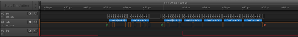

2022-09-28 11:55 PM
it should work, for reference I am adding a shot from a working i2c. I assume you are using official samples, no samples marked as ES (Engineering samples) ?!
Best Regards, Ulysses

Amazing, that will definitely help us.
Yes, they are official samples.
I will do some tests and i will come back to you guys.
