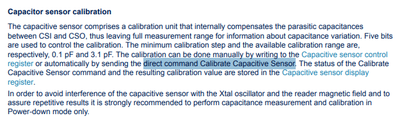

The mentioned coupling capacitor is the capacitance adjusted when using the direct command Calibrate Capacitive Sensor:
(DS11793 - Rev 8)
So no external MLCC coupling capacitors are required.
(DS11793 - Rev 8)
