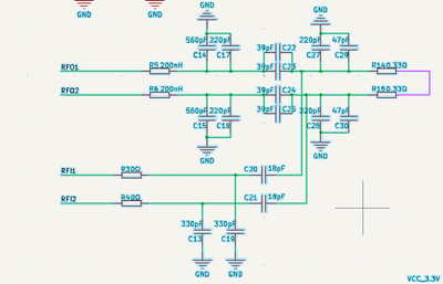

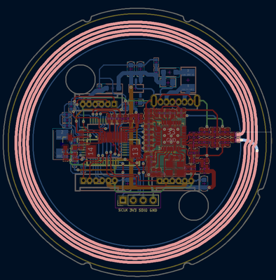

This is a custom-made PCB antenna board utilising the ST25R3911B chip, but I am unsure how to proceed with impedance matching debugging and parameter configuration.
Could you offer some guidance? Below are the antenna dimensions, the calculated impedance matching values, and the original impedance matching diagram. Communication is currently possible at very close range.
To increase communication distance and stability, what modifications should be made?

120nH antenna inductance seems very little for a 4 turn antenna with approx.. 30 to 40mm diameter.

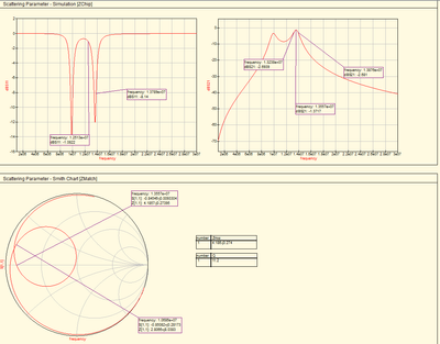

Could you please share a smith chart of the antenna and antenna + matching network?

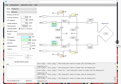

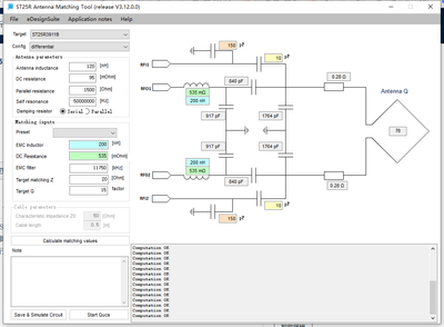

The impedance matching network currently in use is shown in Figure 1, with STMicroelectronics' official analysis depicted in Figure 2. Compared to Figure 3, the present reading range is limited to 5 cm. How might we optimise the antenna to achieve a reading range of approximately 10 cm? Alternatively, could you provide a correctly designed circular antenna? Owing to the lack of equipment for measuring antenna parameters, we can only input calculated values for impedance matching.
