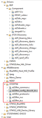

I'm working on ST25DV64KC, especially on FTM mailbox function and EH power supply. Current situation is I need to test maxium frequency avaliable for supplied by EH(STM32L476VGT6 with ST25DV64KC) while communicating through mailbox(FTM). The plan is to modificate FTM part(of DISCOVERY firmware), and remove all related part of LCD/Touch screen source code, let a data transfer triggered by SW1 button and also compatibility the protocal used on Andriod app.
However, I found it difficult to use the firmware on FTM because of lack of documentation of the part of source code, as it highly abstracted. So i wonder if there is other way(like some other example project/code provided) or a detailed docmutation i can refer to? thx

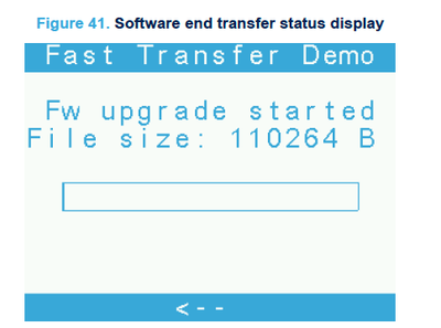

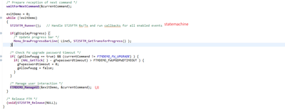

As I've checked, this FTM example is based on state machine process, and it takes me a while to figured out that as datalength is set and turn to shown in figure 41, it's wating for a reader to trigger the process. (later i found it said in um2949:face_with_rolling_eyes:
:frowning_face:If it's possible I do hope there could be a state transition flow chart that can describe the overall work flow for a better understanding.
